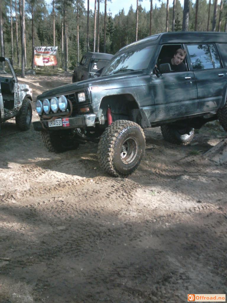

her er min patrol
Frank R Fossen
Patrol 39"
